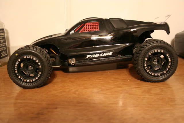

    I did mine with all stock stuff. I cut the steering arm off and made a spacer out if it. Now I have more adjustbilty and it looks stock and is stronger then the all rpm deal and it uses the stock arms

    Using bigger rims would be fine. But for the 1/16th wheels, the inside of the rims can't pass the blue bolt whilst turning.

    LOL what are you talking about??? this is a stock jato with stock jato tires and wheels.

    Sorry, I should clarify.
    In the original post, he's using the 1/16th Proline beadlocks. He is also using RPM A arms, which he didn't list. You cannot use the 1/16th Proline beadlocks with the stock A arms and this mod.

    Ok now it makes senes. Yes your correct

    Quote Originally Posted by jjlogue3 View Post
    I did this mod about a year or so ago and took all the pictures with my cell phone and the pics were horrible! Here is an updated version of it and I can say that I have been running this mod for a while and have no complaints. It works awesome and wheels and tire choices are awesome! I am currently running the Proline Titus beadlocks (p/n-2713-1x) with Dirt Hawg tires (p/n-1071-00) or as a combo (p/n-1071-13) but I haven't really ran them yet as I am still in the break in stage of my new TRX 3.3.
    Here is the shopping list-
    RPM Electric Rustler Caster Blocks 30 Degree p/n 80712
    RPM Electric Rustler Front Bearing Carriers p/n 80372
    Traxxas Suspensionn Pins 2.5x31.5mm w/ e-clips p/n 3740
    Traxxas Electric Rustler Front Axels p/n 3637
    Traxxas Hexes and Axel Pins p/n 3654
    5x11x4mm Bearings
    Ok now with the mod!
    Here is the before picture with the stock setup-
    Pic with replaced parts removed-
    Difference between the two spindles-
    Drilling out the bottom of the new caster (where a-arm connects) with a 1/8" drill bit-
    Installation pics-
    Finished product-
