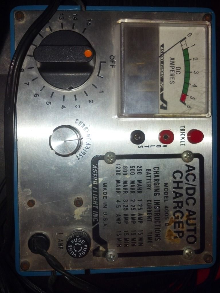

    This is the charger I used. The battery got a bit warm at 15 minutes. At 3.25 amps.

    Try discharging/charging the battery a couple times with a charge 0.5-1.0 amps. If it has been dead for a year, doubtful that it will come back.
