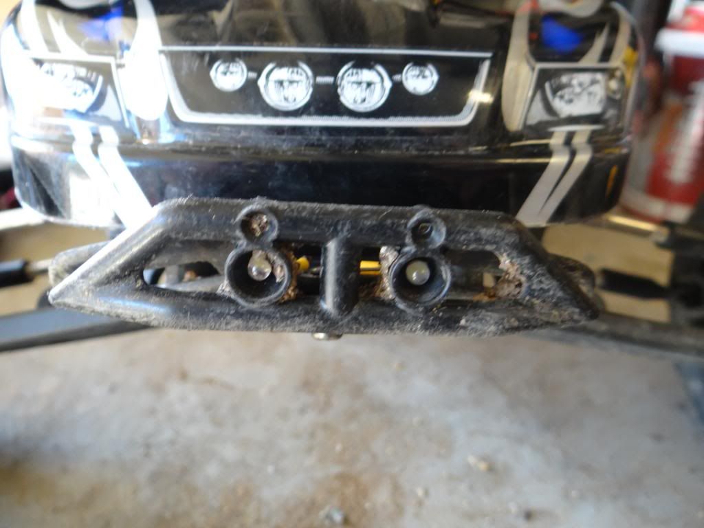

    Here are a couple of pics of the lights I installed on my Jato.
    The front lights / bumper are from an older Losi mini buggy. The bumper with light pods mounted right up to the existing Jato bumper/skid plate.
    I used 3mm high intensity 3 volt leds wired in series, no lenses.
    The rear light pods are rpm rear tail lights with red lenses and 3mm leds also 3 volt, wired in series, and then paralleled with the front leds for the 6 volt operating voltage from the receiver.
    Should have taken pics before driving in the dirt but they do work great!!!
