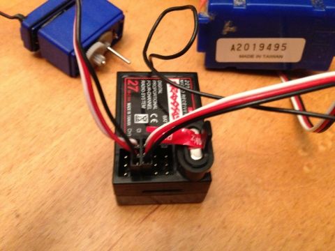

    So the ecs turns on and stays lit red? if it smoked some it could be bad now, all mine would do when it was bad was blink green if the button was held, are the wires hooked up right? should look like this
    This is what the inside of your servo will look like if it's cooked, did the servo turn hard to one side before it quit?

    servo is burnt out. but esc still isnt turning on?
