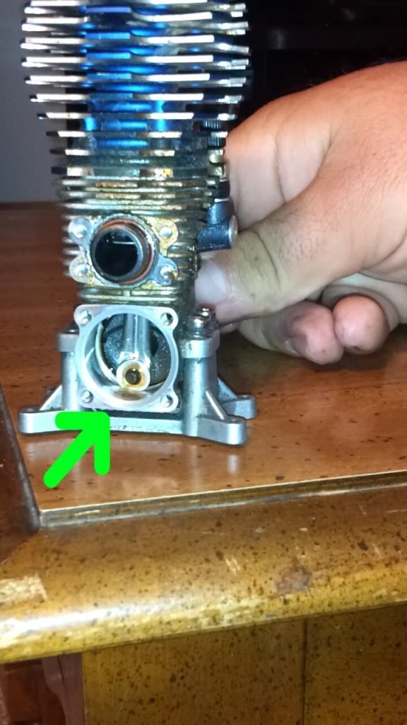

    Hi everyone! Im new to the forum. I bought my T-Maxx 3.3 used and am rebuilding the motor. My questions are should the connecting rod touch the crankcase here:

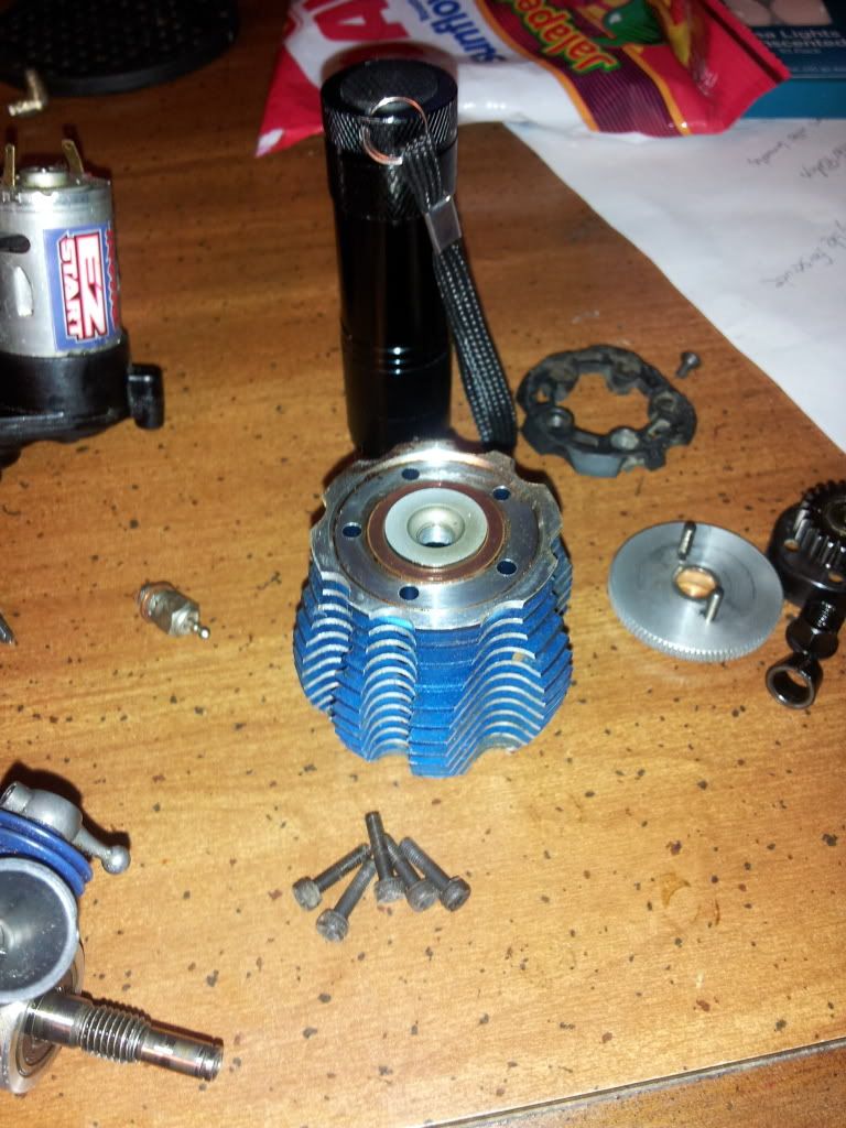

    The con rod has wear marks on the bottom and the case is scratched up a little. Gonna replace rod, but didn't know if case was ok. Other question is should I change the head gasket or is it ok?

    That groove in the crankcase that the rod goes into is correct. It's a guide slot to keep that end of the rod on the crank journal while the motor's running.
    Head gaskets can be re used as long as they aren't bent or distorted. Just make sure you tighten the head back down in a criss cross pattern.
