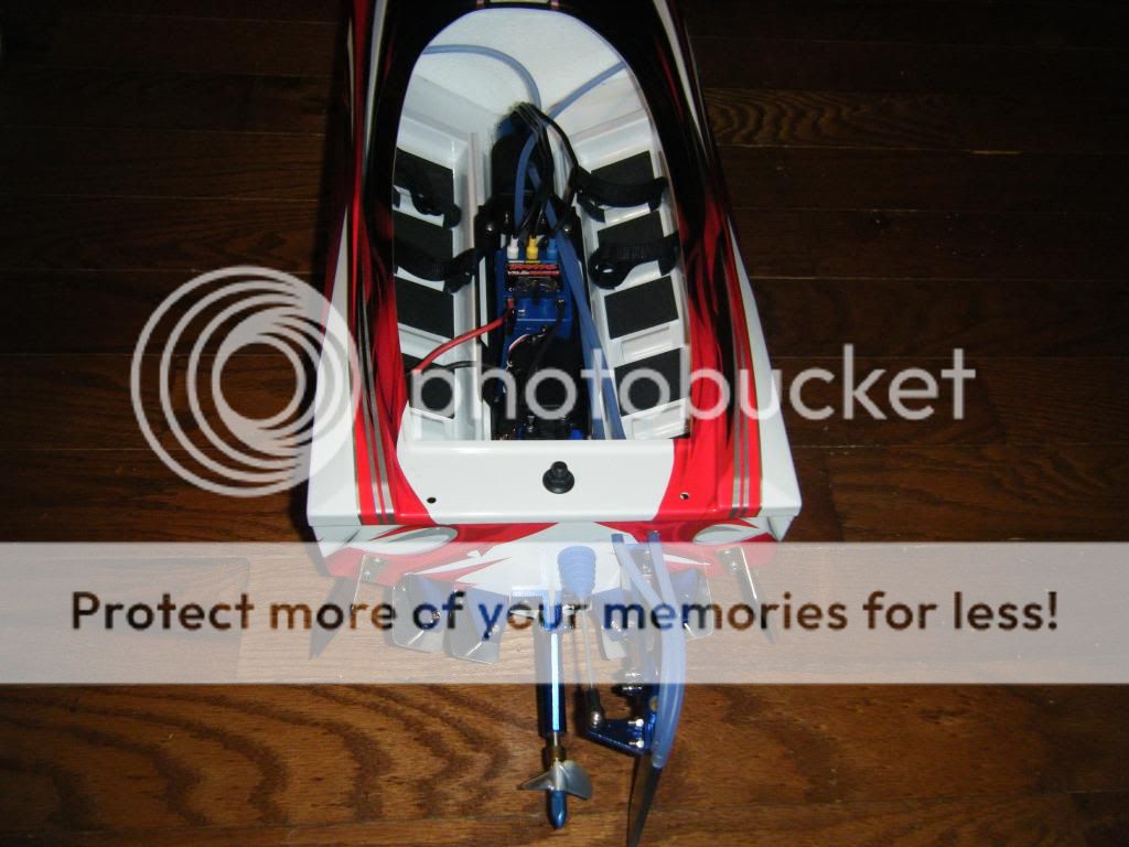

    Well Traxxas did right and fixed my stuff under warranty. Only thing that stinks is they couldn't tell me what was replaced or what caused my problem so I'm not sure what exactly I need to change to stop it from happening again.
    I will say that when I took it apart the flex shaft was a little bent out of shape and I could see the heat it had caused on the casing. If that wasn't the cause I'd imagine it was a contributing factor.
    Oh and while I was waiting on my parts I figured I'd get started on the upgrades. Here she is alive again!
