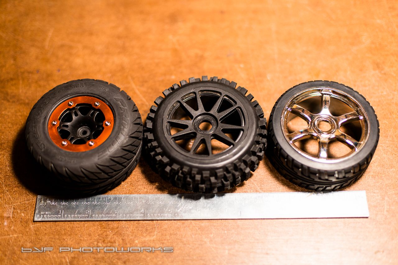

    Typical wheel sizes for the Rally are the standard 2.2/3.0, Thats expressed as inches for the front and back. For these the front looks liek ahigh profile tire where as the back is like a low profile tire. The tires will only fit on the rim one way. The rims use a 12mm hex drive hub.
    The other common used tire is the 1/8 buggy wheel, which is about 3.25 inchs in diameter. The tires are a lower profile and will fit on the rim independant of side. The hex drive on these are 17mm. Adapter are required for the Rally to use them. There are vairous other bigger wider tires and rims, but for the skae of this discussion we'll keep it to these two common ones.
    If you are wanting to get Derrigers for the OEM rims, you need 2.2/3.0 tires. The other size would be 1/8 buggy, you will need new 1/8 buggy rims and 17mm hub adapters for those.
    All Duratrax and Proline tires come with the foam inserts, so you ar enot required to purchase those separately. THere may be the odd case where this isn't ture, but not for anything I have purchased.
    Balancing is not required, but I recommend it, and balance all my tires if possible. It really helps the vehicle to run much smoother and track much better. For balancing weights you can use putty, however I'n not a fan of that and use lead tape designed for RC tires. This is available at your hobby store or on ebay.
    Left to right: 2.2/3.0, 1/8 Buggy, 1/8 GT8, same rim diameter, smaller diameter tire
    Left to Right: 2.2/3.0, 1/8 Buggy, 1/8 GT8. Note the hex drive size. 12mm for the 2.2/3.0, 17mm for the others.
