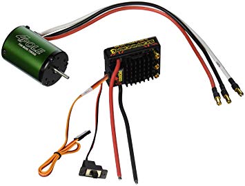

    castle motor with traxxas esc
    Can I run this motor with the Velineon 3m esc? Would I have to change the bullet points?
    I know I would need a 550 motor mount and stuff to fit it in a 1/16 summit
    I like free stuff!

    Hrmm. Is that the castle sw4 combo? If you have the brushed version it will work if you get some adapters 4mm bullet male to 3.5 mm female, or if you solder it. I use the great planes adapters from amazon to use that motor in my rustl4r. They work well. If you have the brushed version, it comes with a 550 size motor. If you have the vxl version it comes with i think a 380 motor. So buy the brushed version motor mount and you should be good.

    It is the SW3, and also what i have. But the connecters are the same. I think...
